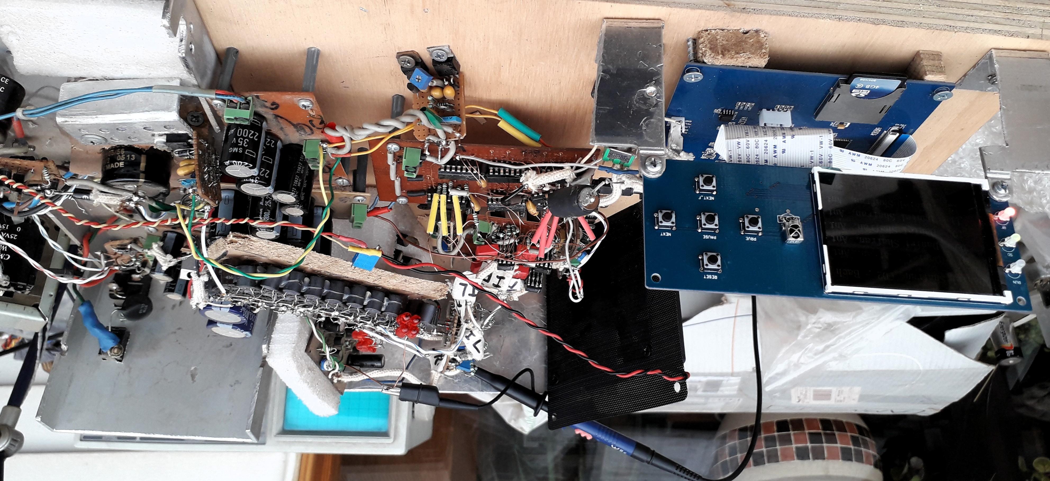

The DAC building adventure has been very entertaining so far, though my physical execution lets a lot to be desired! :D
M.
PS: damn! I don't know why the pics get upside down...

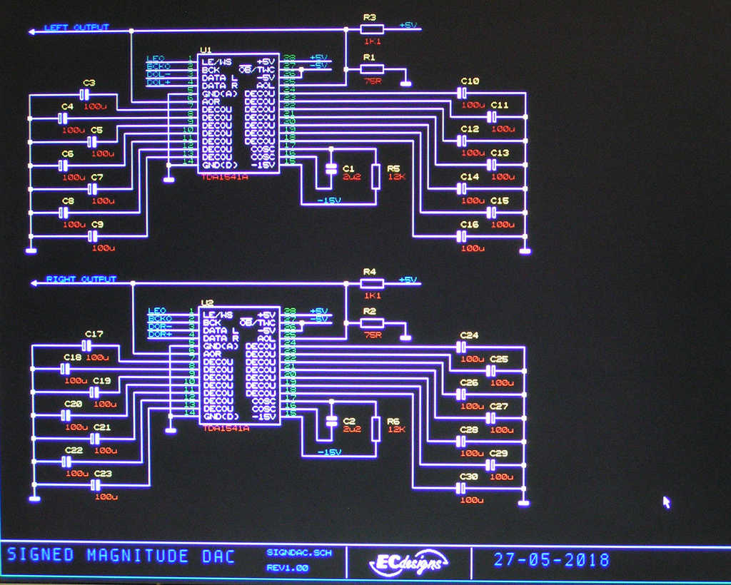

Need to reconfirm re 100uf caps, do we orientate with negative leg of the caps to ground or ???
Thks
!00uF/25V caps, plus (+) connects to GND (0V). Minus connects to the pin of the TDA1541A.
Reason: the DC voltage on the 14 TDA1541A decoupling pins is negative (-12 ... -14V typical) with respect to GND.
1uF film cap between pins 16 & 17, 12K resistor between pin 15 and pin 17.
See attached schematic.

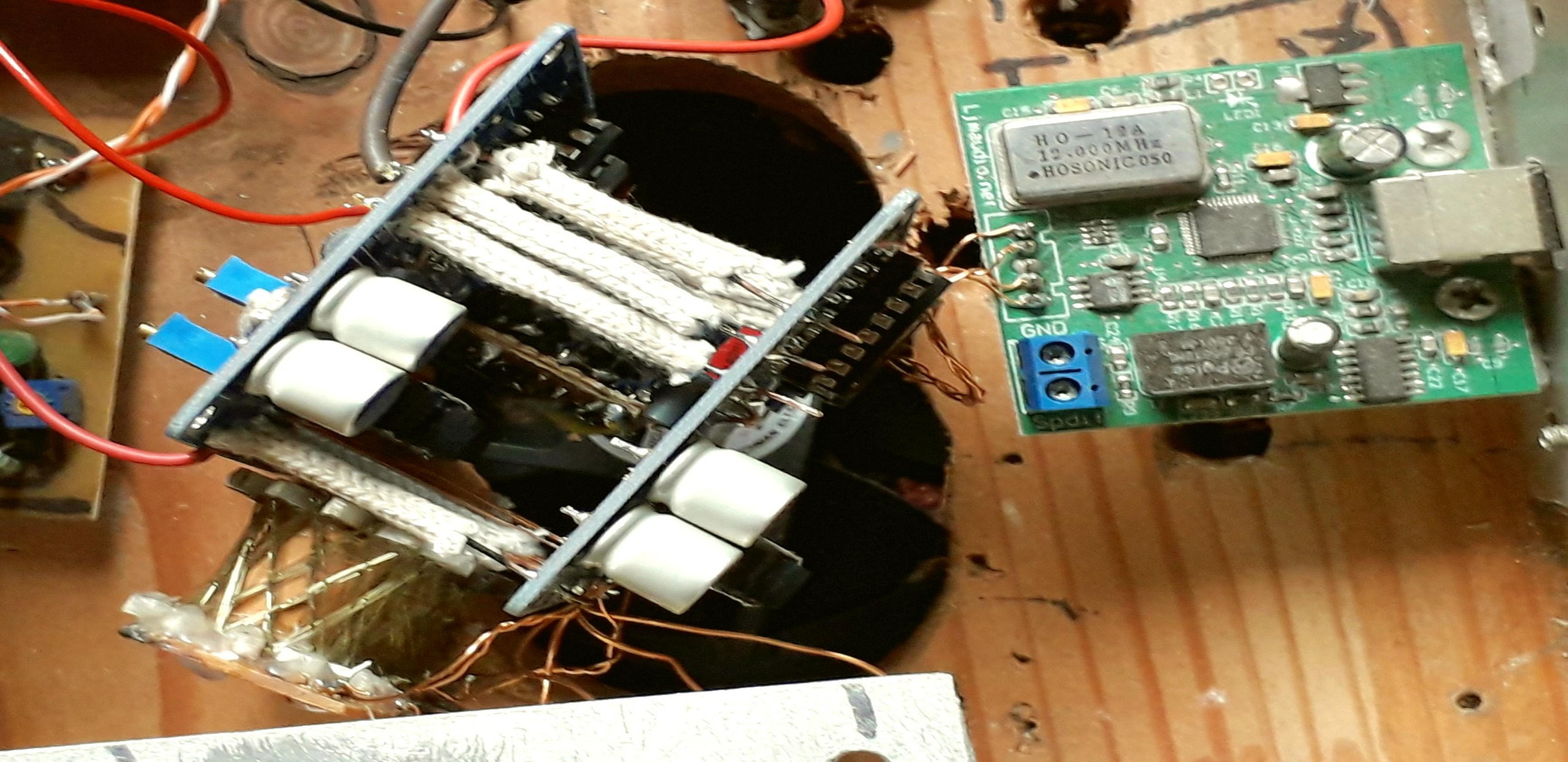

Meanwhile, I am perfecting my TDA1543 DACs, the "scrambler-interpolator" and the "dual-mono" DACs, that may be less detailed and noisy but that surely have dinamics and impact to spare...
I confirmed what guru anticipated, that sometimes the digital chain of the dual-mono DAC refuses to ride more than a certain number of DAC chips- In my case I have only a couple of successful 8 chip towered DACs. The rest seem comfortable with only 4 chips tower DACs, so I am building a two module DAC each with 4 chip towers, in parallel. :cool: If that goes OK, I think I will expand the idea, but, will I get more bit depth???
M.

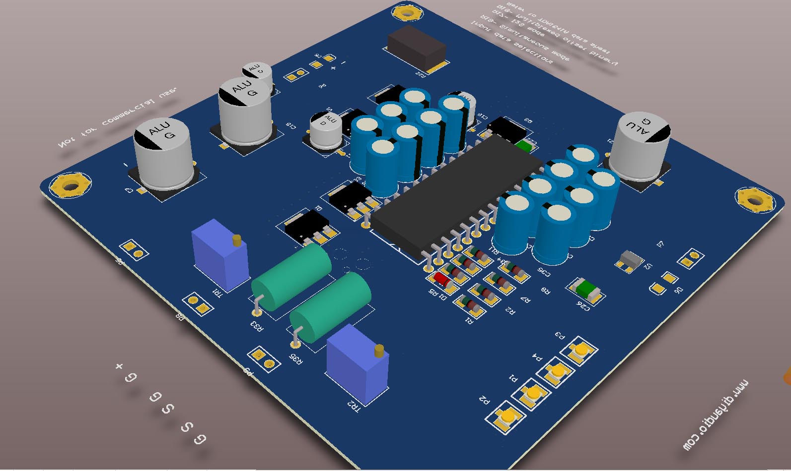

If you do destroy your PCB, ill give you one of these i've been working on:
Yeah going to keep the "zener string", but i've changed a few things to make it less confusing and easier to implement. I'll start a new thread soon, maybe get a list going to see if its worth doing a big order to get the price down as low as possible - 4 layer pcbs aren't too cheap in small runs.
