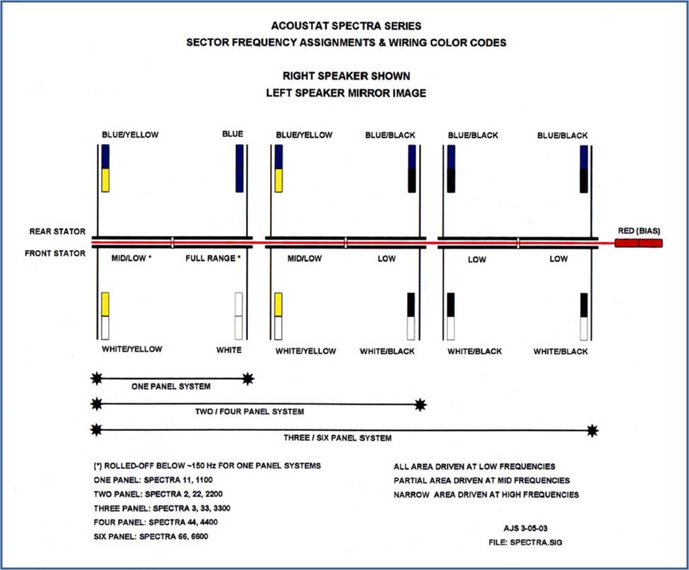

All Spectra models, regardless of size, use the same 1/2-panel width for the full range sector (i.e. the only area playing high frequencies). Therefore, I think the sound of all the Spectra models is very similar, with only bass extension and dynamics increasing in the larger models. In this way, the Spectra series solved the compromises inherent in the older models - that is, narrower models tended to have the best imaging but limited bass capabilities, whereas the wider models had better bass response but inferior imaging. With the Spectra series, the same character of sound is available across the model line, with merely more of it as the size and price goes up. Perhaps you can tell I'm pretty proud of what we accomplished in the Spectra series - I am!
When I left Rockford, I was using Spectra 1100's, and a few years later when I switched to 4400's, I felt that I lost NONE of the imaging qualities of the smaller speaker. The only changes were positive - more impact and bass extension. So, if you like what you hear in one of the smaller models, I feel confident that you will also like any of the larger models.
What he said, only in graphical form ;)

When developing the larger Spectra models(3 panels wide) did you experiment with the horizontal placement of the 1/2 panel portion playing full range? (inside placement .vs. centered .vs. outside)
No, we did not. The resistors feeding the mids/lows and lows-only sectors create a time delay (as do all R-C filters), which effectively creates the curved dispersion: electrically curved instead of mechanically curved. Therefore, it makes sense that the full range sector is close to the the inner edge of each speaker, so that adjacent sectors are time-delayed (or curved away from the listener) for a smooth dispersion pattern.
If you didn't know, Spectra is an acronym for Symmetric Pair Electrically Curved TRansducer.
This is not to say that other arrangements of the sectors would not yield acceptable results, to some ears, but I think the factory arrangements do make for the best imaging/sound stage in the widest variety of rooms.

The reason I had asked about the placement of the full range section in the larger Spectra models is that I have been experimenting with my own wire ESLs. In general I found the sweet spot to be larger and imaging more stable when the full range section was placed in the center and the ladder resistor networks worked outwards toward the inner and outer edges of the panel. However, my panels are not nearly as wide as the Spectra 6600 so perhaps keeping the full range section away from the side walls with the large Spectra panels is more advantageous.
