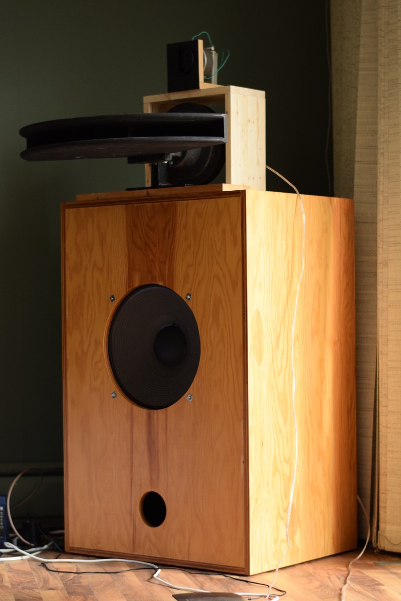

I use the JBL 2225, which is a lower power version of the 2226, in my main speakers, and I love them. In a large cabinet, around 8.5 cubic feet, they are good to below 30 Hz. I cross them over at about 1 kHz.
Hi Pinholer, Albert from Vancouver. I came across the forum and found your beautiful built. I have a pair of 2226h and want to run them low as you did. Appreciate if you can let me know more. You are welcome to message me. Thanks

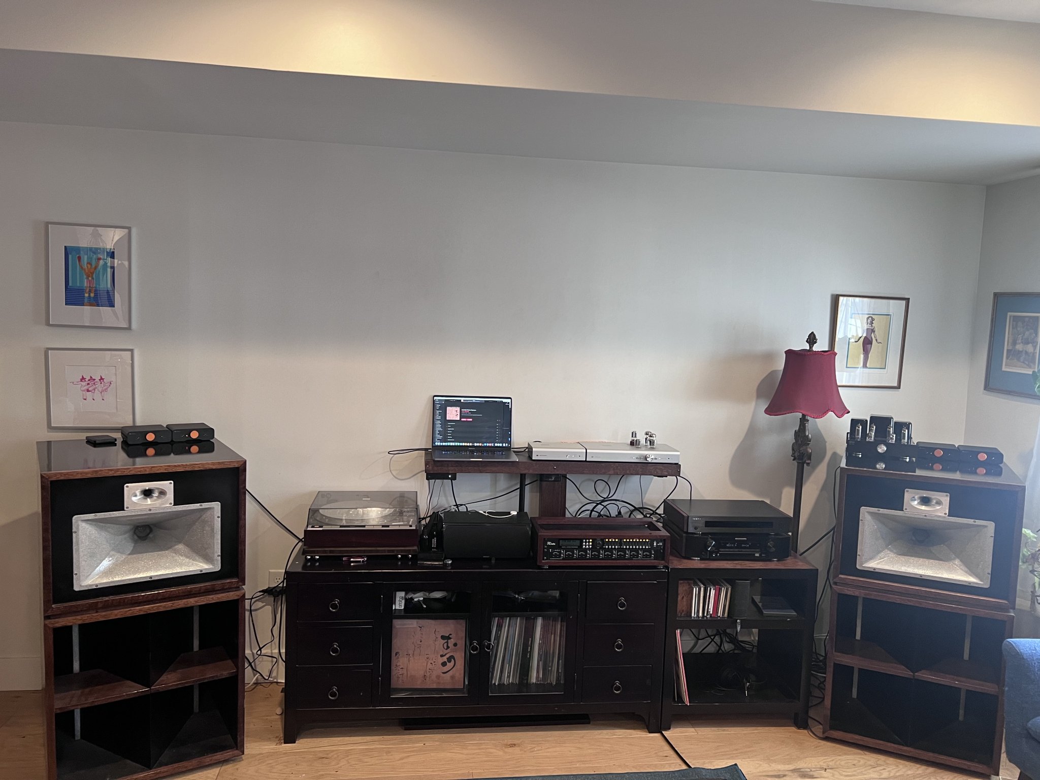

I also use the 2225H in my mains:
they're good down to 23Hz, with the aid of a passive radiator.
Reactions: 1 users
It's measured and audible or just on paper? I'm really just curious.

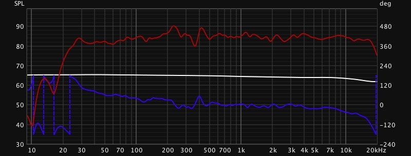

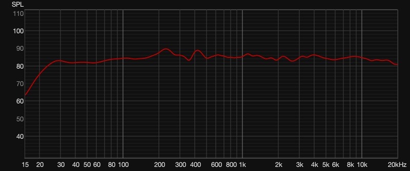

measured response. The design is based on LaScala, the bass bin is similar, albeit with corner reflectors, bracing and made with 1" BB. They're doubled to the upper horn enclosure, which has had its volume increased by nearly 100% and sealed in the rear. I had intended to do the DJK port mods, but I also had a pair of Dayton Audio 15" passives; (all of the parts had been collected to make a pair of speakers based on the Chorus, but with a 2" solid wood baffle. However the cost of the hardwood and hearing the LaScala drove the change.) So I did some modeling in HornResp and WINISD with the bigger upper cabinet and found that it would extend to at least 28hz, which was more than my goal of 30-32Hz.
at any rate, measurements revealed even more. this is from my most recent session, trying to tune them in with a Thomann T.Racks FIR DSP 408
with Phase alignment, using a quasi-linear filter scheme.
