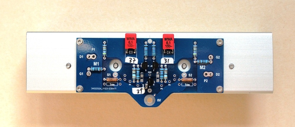

I would encourage others to build the same.
It is very simple to build, and works first time without issues.
There is no reason why it should not work with equivalents in TO247 packages.

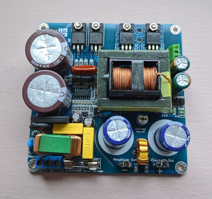

As mentioned earlier, we intend to use a 85V SMPS for supplying the laterals.
We bought a Connex SMPS300RS 80V at a good discount from a EU distributor.
A few quick checks :
Input / outputs are electrically isolated.
Max main output voltage is 84v by voltage adjust.
Aux output is nominal +/-15v, outputs unloaded is measured at -15.87v, +16.40v.
This is too low for the frontend, and most probably too noisy.
So a small separate linear +/-18V supply will be added.
Patrick

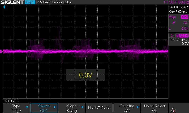

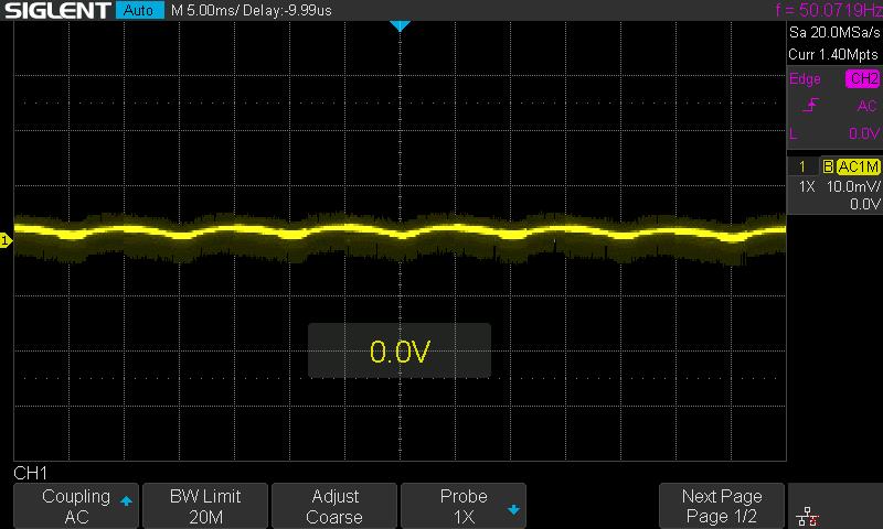

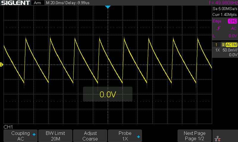

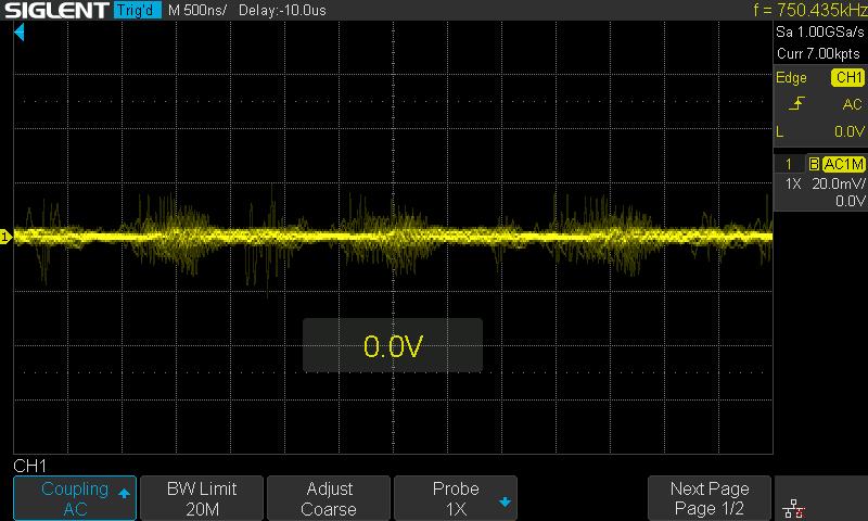

The 80V (nominal) output is regulated.
So how regulated is regulated ?
The surprise to me is that rather than seeing switching frequency ripples, we see 50Hz instead.
Maybe it will become less with heavier load.
But we shall add a cap multiplier downstream.
No load.
90mA load.
Patrick

Jan Didden :
https://www.linearaudio.net/nemesis-rebuild
"...because of the output transformer, it was very difficult to get rid of hum that would be coupled from the mains transformer to the output transformer.
A large chassis for physical separation of the transformers as well as painstaking rotation of one with respect to the other would minimize hum.
But I did not find it satisfying.
The solution with the SMPS followed by a simple linear regulator made the amp very quiet."
And I trust Jan.
Someone who has actually built the amplifier.
Patrick

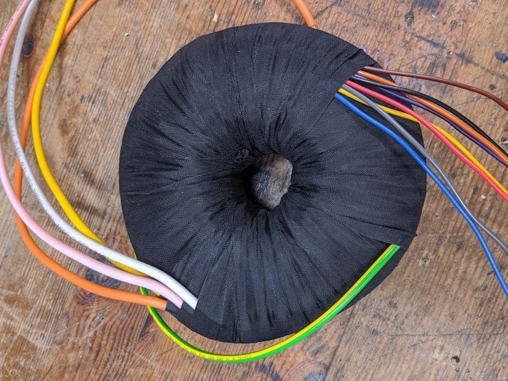

The new toroid (29+29v)+(29+29v) : 4x29V//, so 1:2? 32Ω primary?this will mean that the secondary would only have to be specified as 29V for 8ohm and 20V for 4ohm.

As explained in the article, the toroidal transformer is 58V+58V : 29V.
So it is 2+2:1, or 4-CT : 1, same ratio as Jean Hiraga's.
Also explained in the article,
the reason why we did not specify 110V+110V : 58V is that the windings would not have the low resistance and high current rating as that above.
110V + 110V : 18V would be 12-CT : 1, which will need much higher voltages at the primary, something like 240V.
And then it is not the Nemesis Quadrige anymore.
We have a revised PCB which will allow a stack-on daughter board for the bias balancing circuit.
We shall test that first before making it available.
In our case, because of careful matching and thermal management, we could not measure any differential bias current.
So we shall not be using bias balancing. There is no need to, in our case.
Patrick

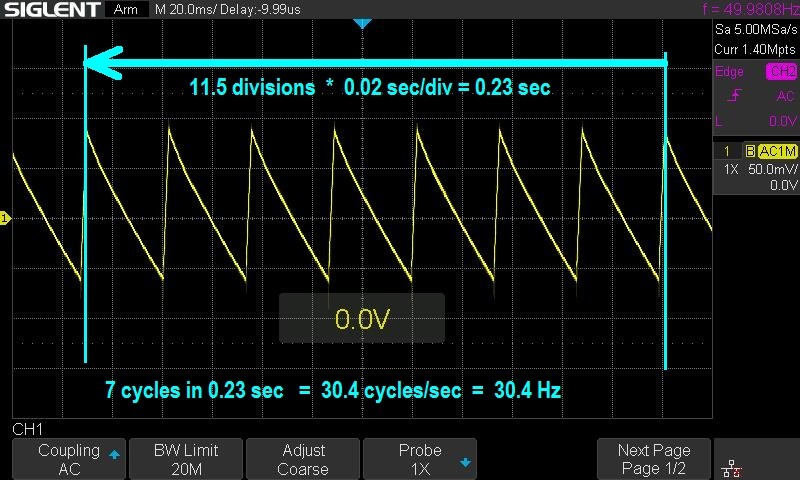

I think we see thirty Hertz, not fifty ?
