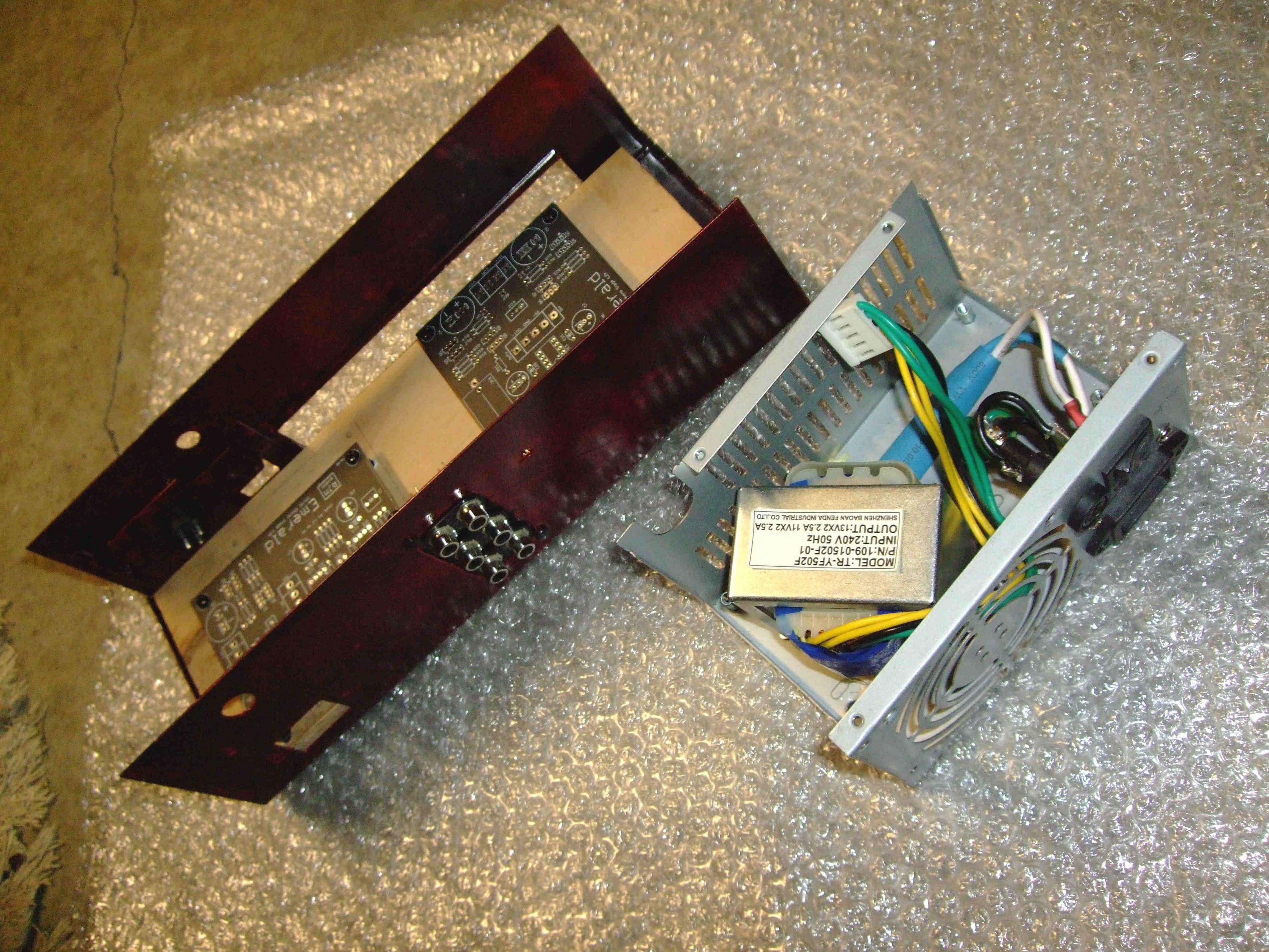

casework done and power supply tested...
My reclaimed transformer has 2x11v or 2x13v outputs...
Am I better to...
a)overvolt a little and use the 13v...?
b)overvolt a little and use the 13v and add heatsinks to the s-reg transistors?
c)undervolt a little and use the 11v..?
d) use the 13v and inline diodes to drop .7v ? (as measured that would give 13.1-.7=12.4)
e) use 13v and that's within 10% spec so live a little ...;) ? 13.1 x 1.414=18.5 so that seems ok as 18v is recommended
Thanks Richard.....transformer seems well regulated with no-load volts at 13.1v a side. So I will try with 18.5v rectified.
