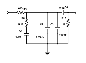

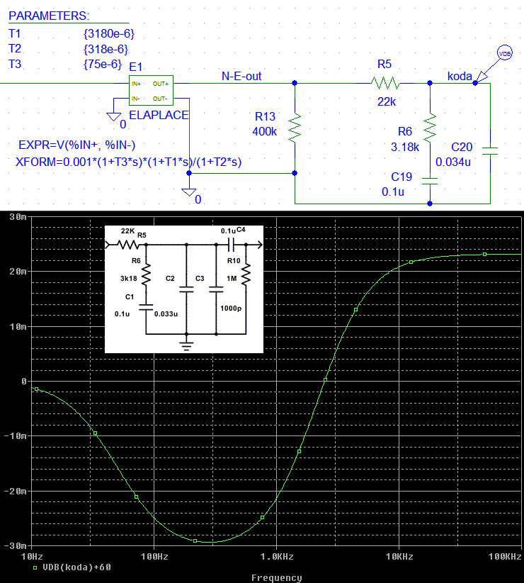

I'm thinking of building the reference RIAA design from page one of the datasheet for the LME49720.
I have the following filter parts available.
I don't see any problem with substituting the following filter instead, but I thought I'd ask the community.
Anyone think this op amp will have any issue with the slightly lower Z?
Thanks.
EDIT: C4 and R10 were in the original design I used with tubes, and I know they can be omitted.
Thanks.
NATIONAL did not have an issue with these values in their Application Note AN-1651.

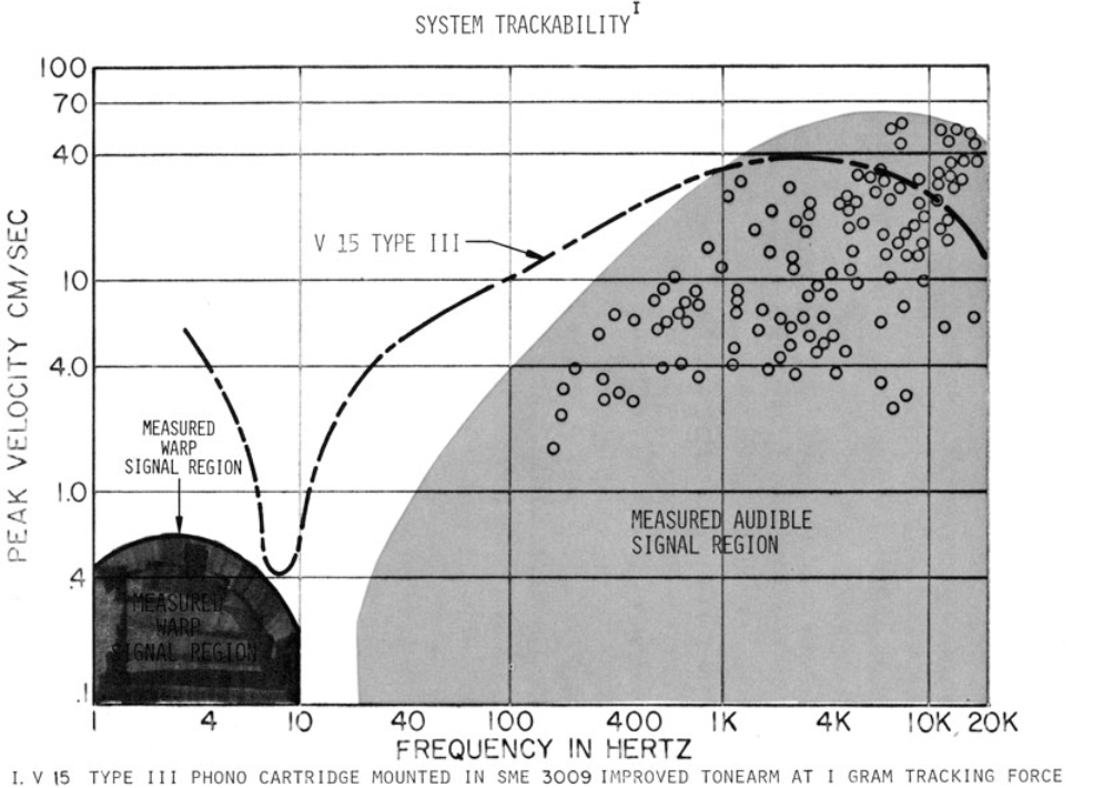

I love the passive RIAA, but one thing to be aware of is that peak signals, particularly on the outer grooves of a recording tend to be "hot". The illustration below is from a Shure whitepaper on trackability but illustrates how much energy you have to deal with.
So, don't skimp on the rail voltages if you want decent headroom.
LME49720 and LM4562 are (or were) identical devices. The max rail voltages in the datasheets for some reason are different.

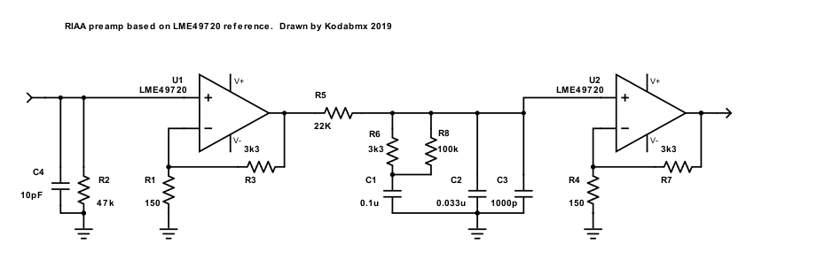

Ok. Here's my preliminary design. I will power it from 2 9V batteries initially.

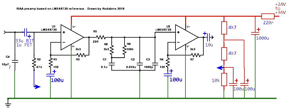

Out of curiosity, How would I transition this to a single ended power supply and a rail-to-rail output? I know the LME49720 won't work, but how about an AD823ANZ? I assume I just need input and output coupling caps?
Thanks.
Thanks.
Also needed are: the U1 positive input DC biased to half the supply through a large resistor,
and large electrolytic capacitors (~470uF each) from R1 and R4 to ground.
Also needed are: U1 positive input DC biased to half the supply through a large resistor,
and large electrolytic capacitors from R1 and R4 to ground.
Single ended -- not a good idea for a passive.
I wouldn't do it, or recommend it, but that's how to do it with a single supply.
BTW, the input biasing for the second op amp comes from the output of the first op amp.

You need to make C4 selectable. Some cartridges require no C at all: others up to 500pF. Shure is typical at 200pF. This is very important for correct response in the top octave, and is about loading the cartridge correctly, not about RIAA.
The 10pF represents the cable from the turntable to the amplifier. I should have said.

Do we know if the op has identifed the type of cartridge?
Such as a Moving Coil (MC) or Moving Magnet (MM) cartridge,
each with different requirement's I'm told?
I didn't see any mention of cartridge in the thread, that is why I ask.
Isn't it possible to taylor a design to a cartridge type and a specific
cartridge? Do we have to consider anything of the various cutting head
types when they made LPs and if there are any issues outstanding?
I assume that is device is only one LMC49720 using the "a" half
and the "b" half for one channel?
Cheers
