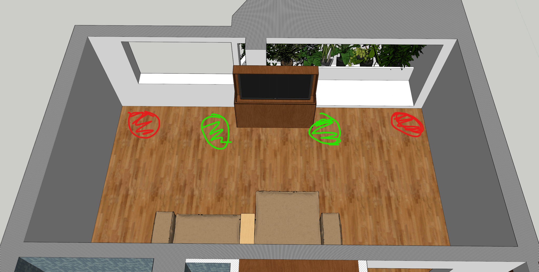

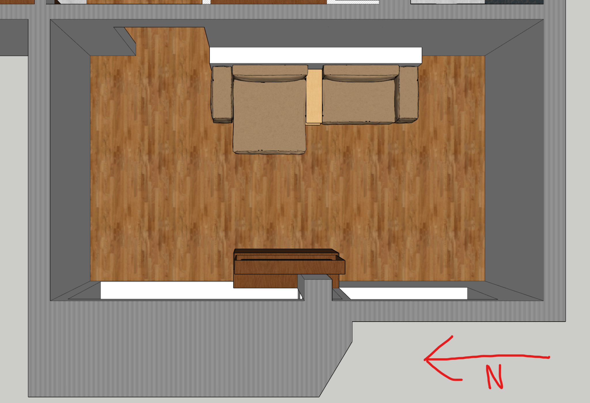

The space is 8.1x4.5x2.6m (uploaded a pic of the space). Also there is a greenhouse (4.5x1.5x2.5m) attached to the room. Total room is around 40sqm. I don't want to change the room aragment. I want to be able to sit on the couch and see the greenhouse, also the sun sets in the window and I want to be abel to see it. Windows behind speakers sucks but there has to be a workaround. Turning the couch 90' will just split the room in two which is not an option or create a 8m long tube. I want it to be a social space not a purpose built listening room.

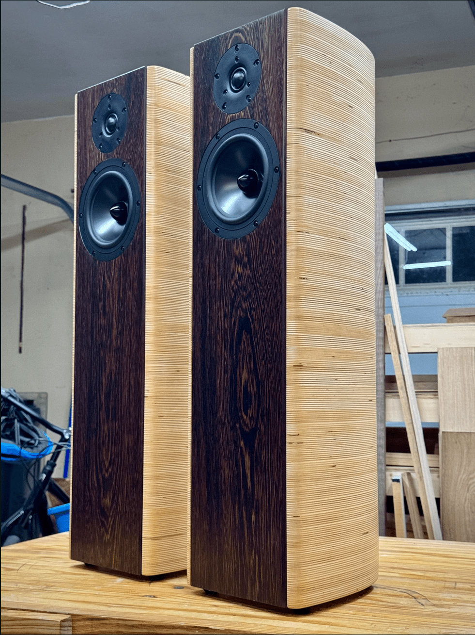

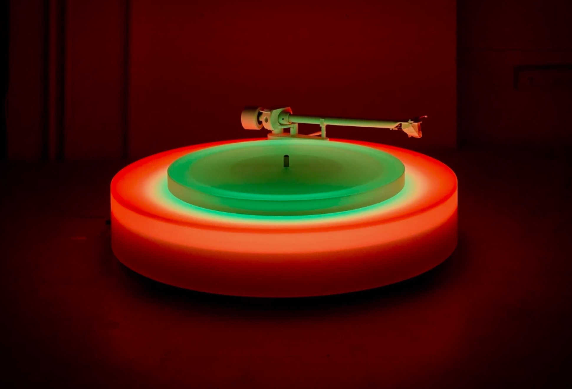

Heres a pic of an aestheitic im going to go for (mainly the plywood) the speakers. And much later down the line. Im going to buy a used hi-end turntable, gut it and make something like this:

The table is pretty, the Magico speakers use translam which is a huge waste and only really useful for doing complex shapes.
All too often XOs suck the detail out of the loudspeaker.
For your budget, and with the idea that woofers will be added later, Alpair 10.2 MAOP in Frugel-Horn XL or suitable Pensil would be a good choice — the extra bass added later would increase potential levels and improve the mid-top (assume a HP filter on the mains). As tpo levels, 95 dB average is very loiud and will damage your hearing if exposed to got too long.
dave
I want to play around with complex rounded shapes. Apart from the aesthetics of bubbly shapes which are really appealing to me, the rounded baffle should help with the diffraction. Translam would give me that look, I can also program la cnc with a nice ball nose and get the final bubble shape as close as possible, then just sand at them a day :D. At then end of the day they will be a design piece in my living room, so waste is not a problem.

In the floor plan the speakers will most likely be in the green position, very central. Red on the right side will interfere with greenhouse access.
