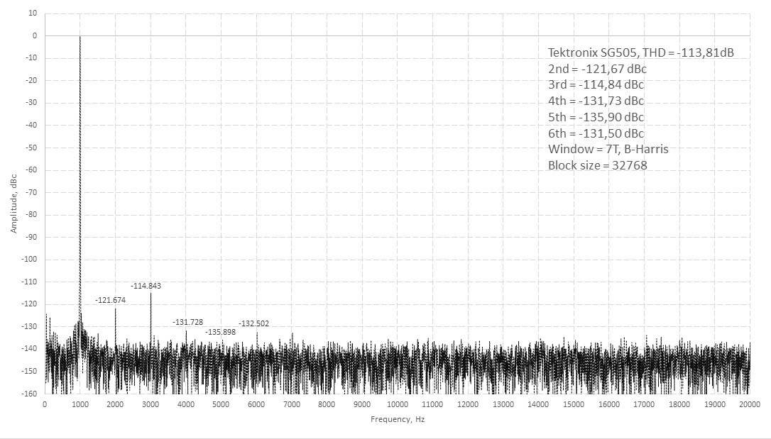

I've decided to make some measurements on my restored Tek SG505. It measures below specified distortion in the datasheet at full output. The measurement is taken with ADS127L01.
Reactions: 1 user
