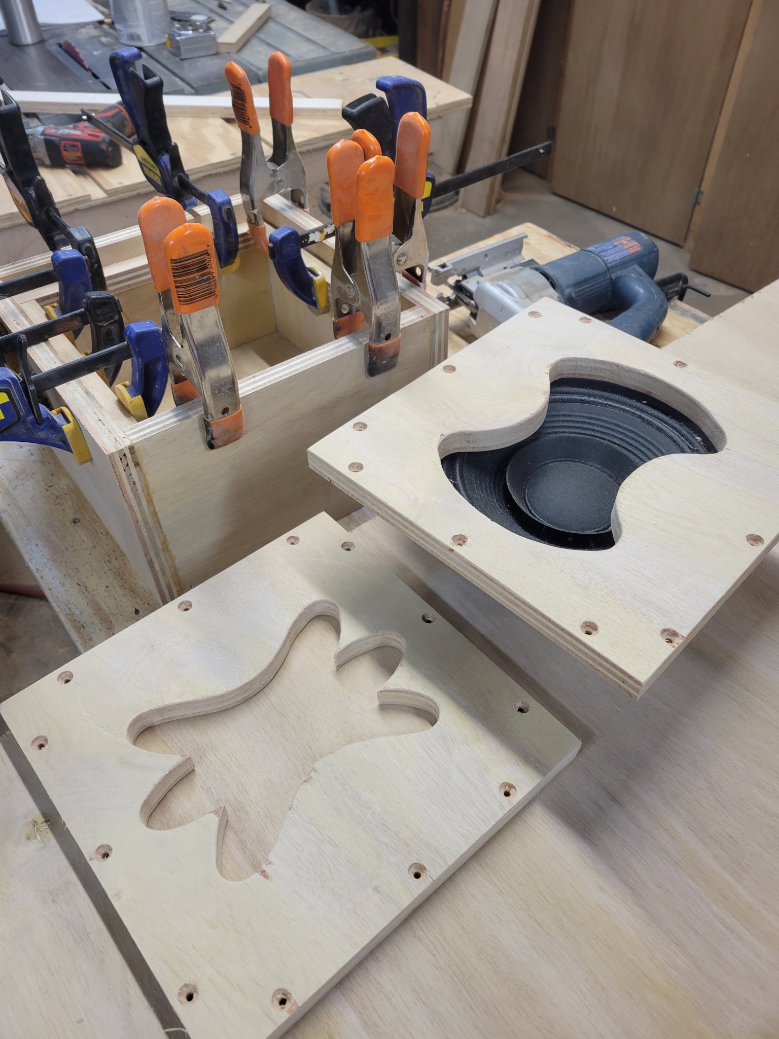

would anyone here like to give useful input on making a new klam? (comments like "burn it" - "fill the front with cement" are not useful - lol- well - "maybe")
I think the last klam12 turned out ok -quite heavy and I've just about lost use of both of my arms. - need to put it back into my world- a klam15 was pretty good. Klam8 and a klam10 - too many intense reflections. The late Marty Poppe insisted on having some open "nose" area. I'd like to keep a new klam12 length and size about like Karlson's K12. System resonance on the klam12 below (left) was near 100Hz as the 12CX had free air resonance around 70Hz and a decent motor. (80oz magnet - 2.5" edge-wound coil).
I have an old Eminence C12CX - with 80oz magnet and protruding horn which would go into the klam. ("clam" as in the Jess Oliver "Magna-Clam" - same as Karlson's AP100)

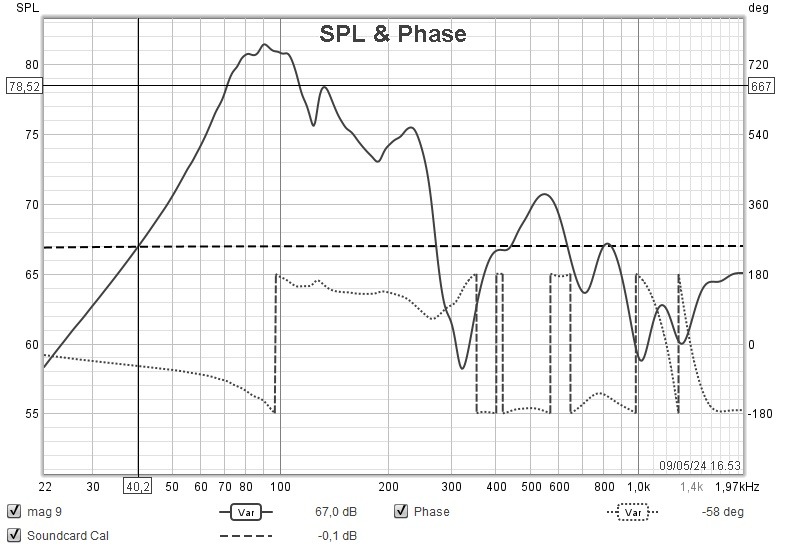

here I put the microphone inside the K12 casing in direct contact with the reflex opening (i.e. no distance from it). I lined the rear chamber with upholsterer's sponge (I know, it's not the best choice) 1 cm thick excluding the wall on which the speaker is fixed.
what do you read?
