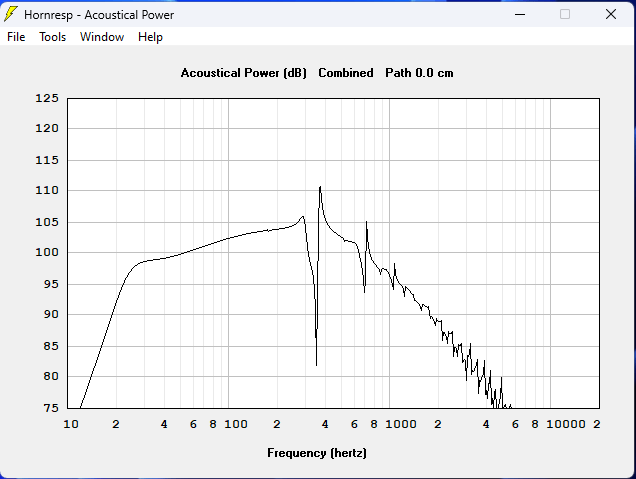

Just fold it back and forth 3 x and put the driver at the end of the first fold. A bit of polyfil in the offset section lines it up ‘perfect‘ by affectively lengthening it a bit (orange trace is after, blur is before)

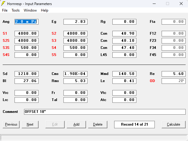

I want to understand the acoustical parts of the offset design before I could be comfortable building one. I have not been able to recreate the response above in HR BR mode, instead of the offset TL mode ... but I don't know why.
The main chamber, not sure what to call it, the driver needs to sit symmetrically in it was what I can tell... I think it must be the path variable. In offset mode, the path, is set my the length of the enclosure where as BR mode assumes you are putting the BR port, where ever.
