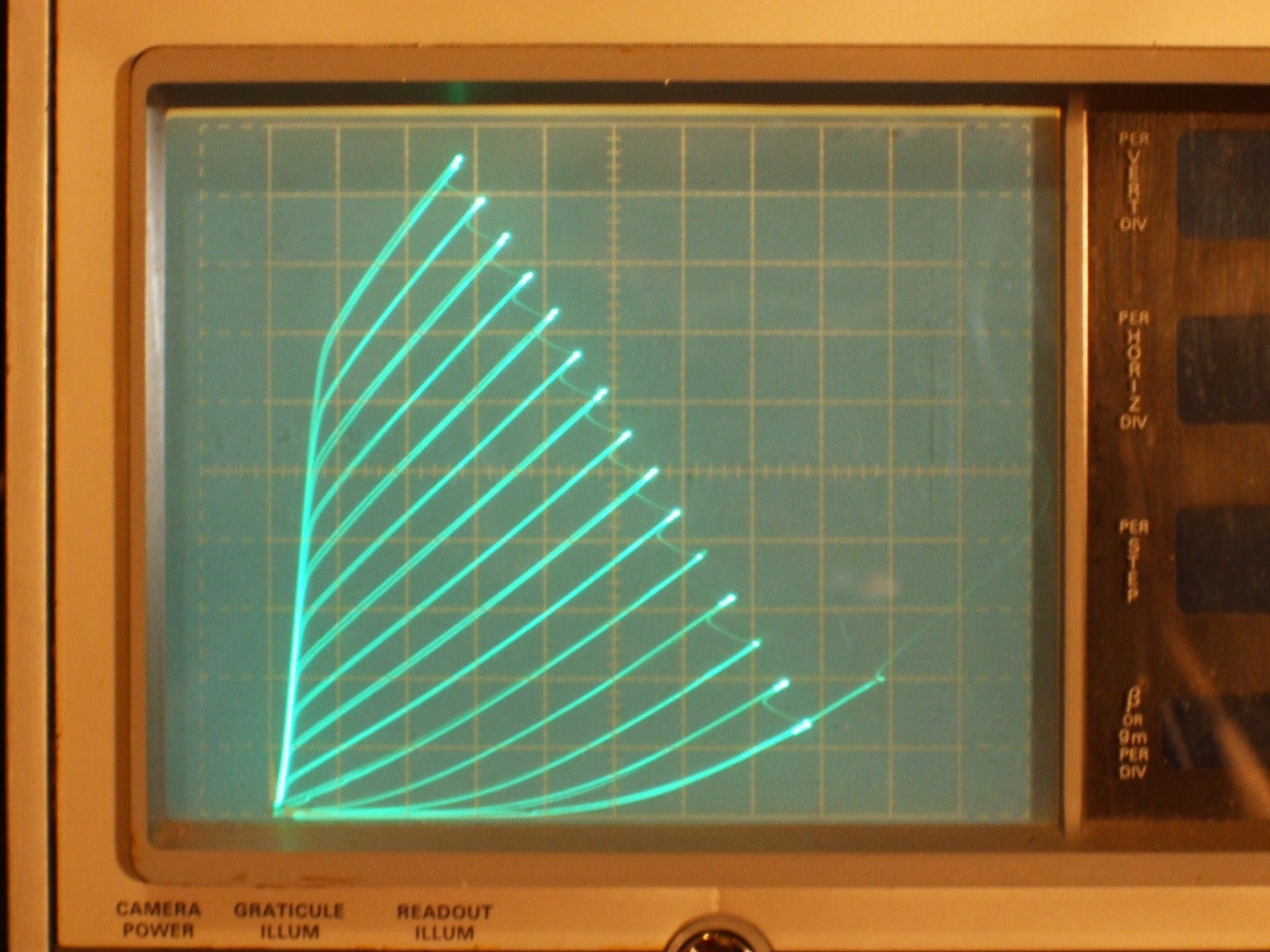

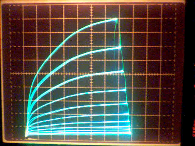

How about a Beam Triode? Here is one that can run on "modest" plate voltage. 6HZ5, 100V/div Horiz., 20 mA/div Vert.

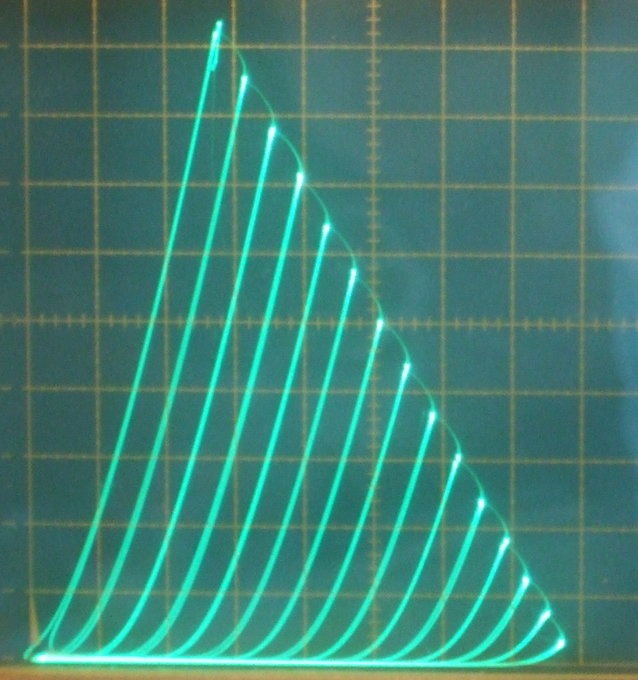

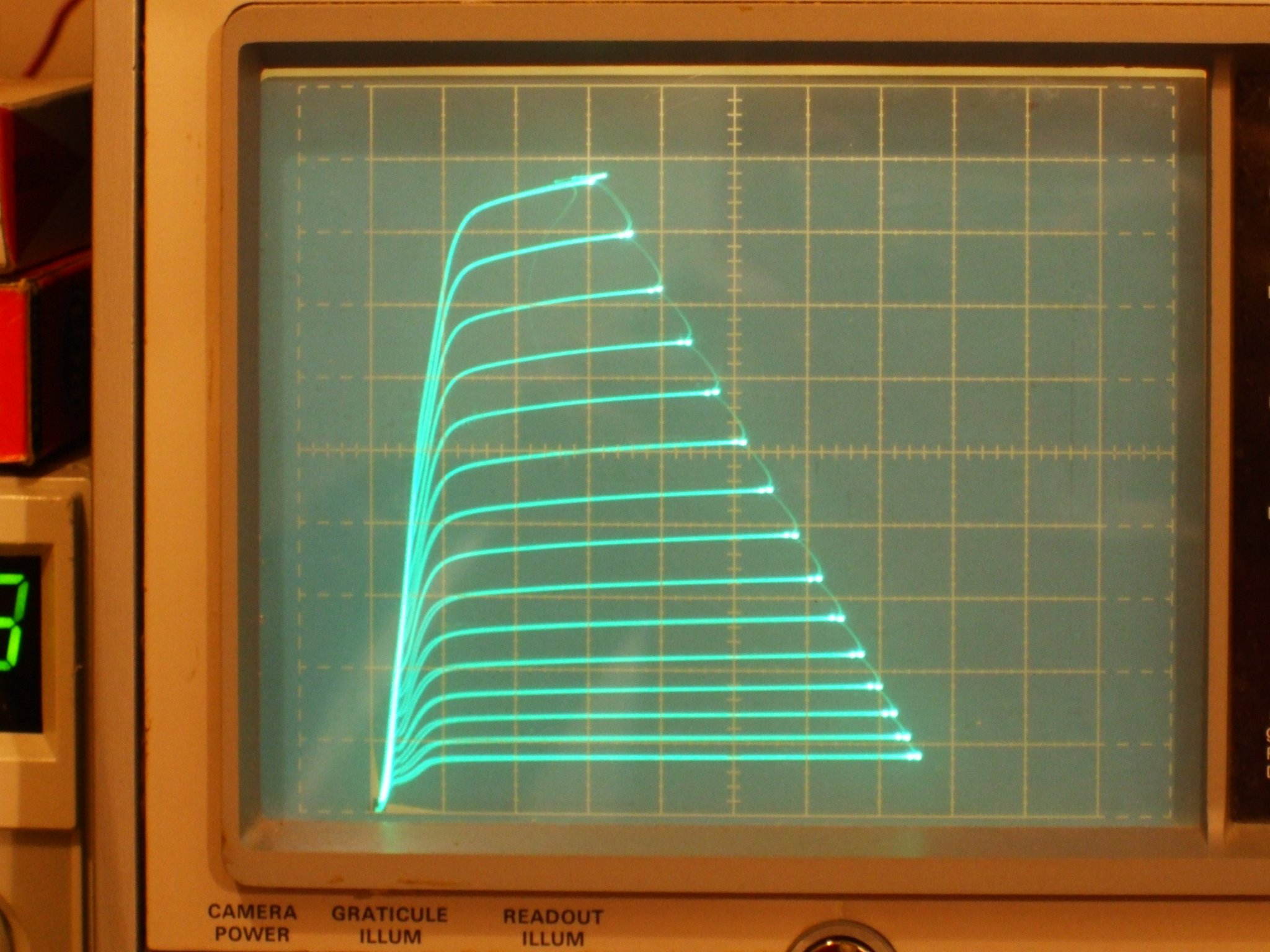

KT77 (JJ) Beam Pentode has more equally spaced curves than the EL37 or EL34. And better triode curves too.

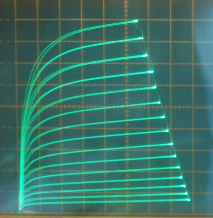

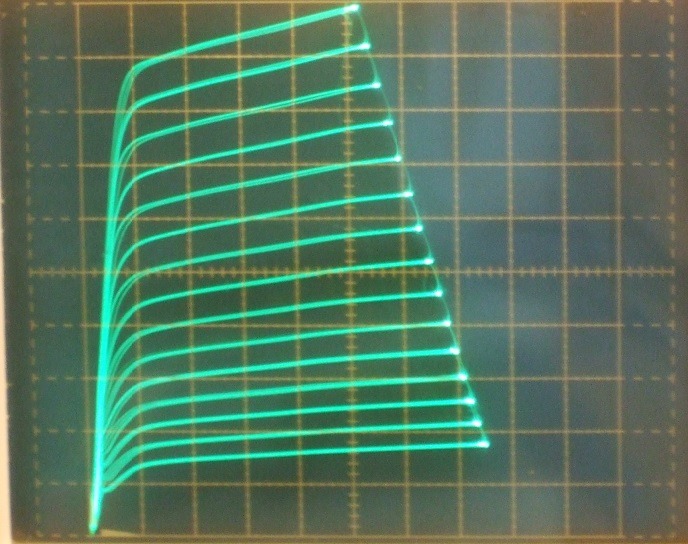

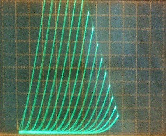

And here is a tube you have never heard of, was on the $1 list years back. And it IS a real pentode with a fine spaced GRID3. 1st pic is with +24V on grid3, 2nd pic is with 0V on grid3. Good for 10 Watt with the +24Vg3 to reduce screen current. Very high gm also. (notice 0.15V grid1 steps) 3rd pic is triode mode.

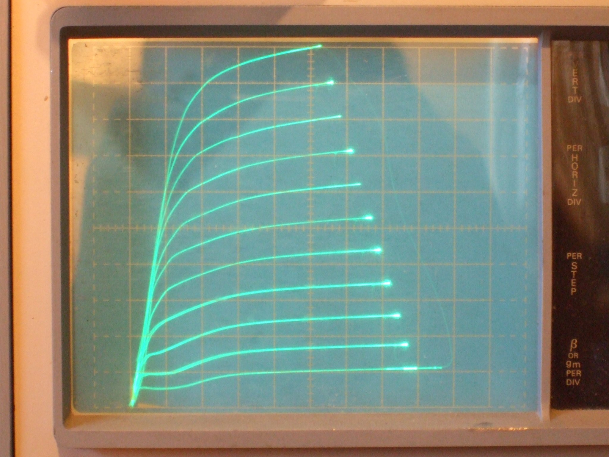

4P1L is another real pentode, where +15V on grid3 improves it's pentode curves (below). 2nd pic is 4P1L with 0V on grid3. And last pic is 4P1L in triode mode. You won't be getting much 2nd harmonic with this triode.

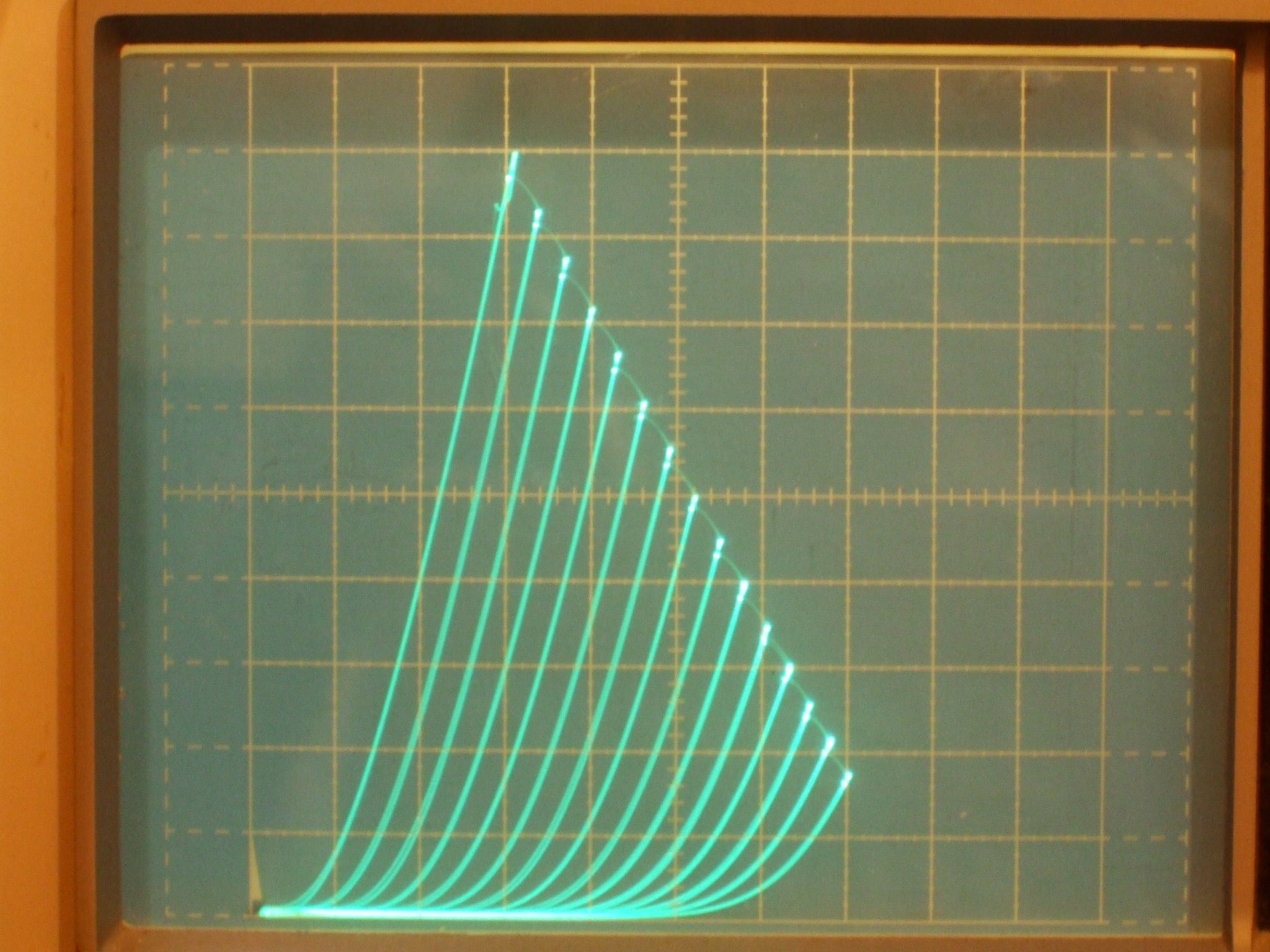

The 1E7G dual pentode in triode mode:
12HL7 10 Watt beam pentode in triode mode. High gm. Another $1 list alumni. No second harmonic around here either.

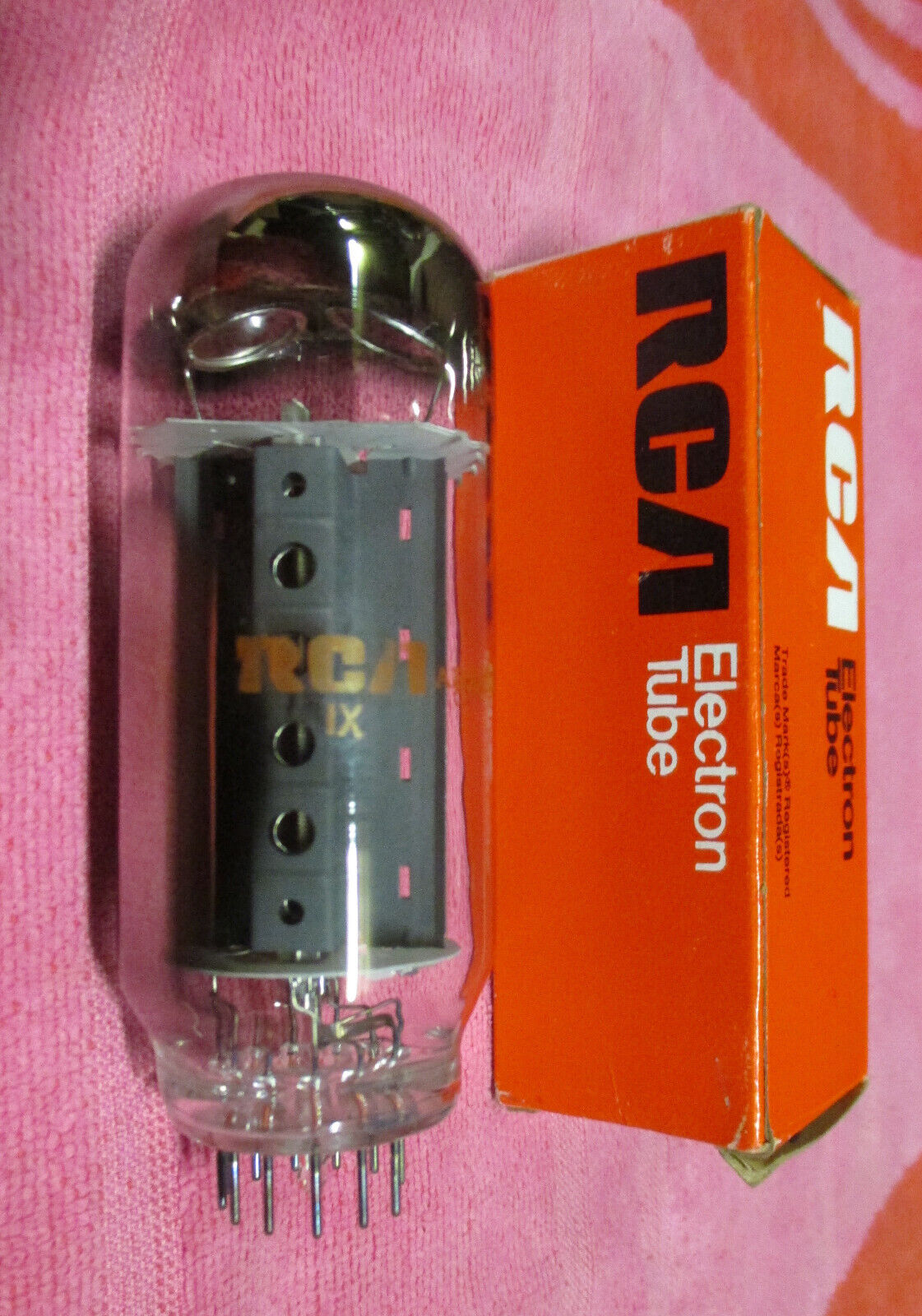

4E27/8001/5-125/Gammatron 257B
Connect as triode, learn to re-getter, and treat as a 5V 845, but better because Eimac quality but cheap. Use two in parallel with filaments in opposite polarity to null AC filament IM products. Max B+ as triodes about +750 VDC, but run them (very) warm, preferably red.
All good fortune,
Chris
Nice. How do they compare to say a good el34 (triode)
If I only need one, would I be looking at dc on the filament ?
