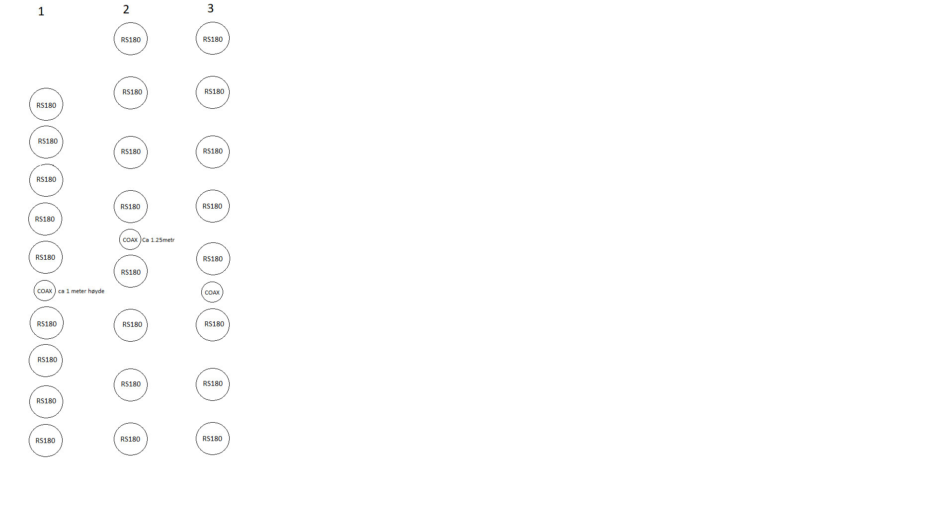

DIY KEF Blade Coax + Dayton RS180 midbass array in baffle wall
I have 3x KEF Blade Coax drive units that I want to use in a new setup in a new house, together with 8x Dayton RS180 per side in a baffle wall.
(I have 3 of these nice coaxes, so there will also be a center speaker with the same setup but with only 4 RS180 mid)
Does anyone here know how to calculate spacing and possibly distance from floor and ceiling, and possibly have general thoughts about solutions?
Appreciate feedback and discussions!
My thoughts are in this way to solve a lot of the room nodes in the elevation plan. Split frequency will be considered, but around 4-500hz possibly with some overlap.
Originally Kef Blade is shared at 320hz, but I personally feel it is a bit low. There will be a subwoofer to take the bass area.
I have a Minidsp OpenDRC-DA8 for active crossover incl FIR.
See picture for alternative placements of mids.
In one set-up, the coax is at a height of approx. 1.25m, which I feel is somewhat high compared to the approx. 1m sitting position?

You're trying to crossover from a point source to a line source. That's not a great idea, it's really difficult to accomplish.
The reason that the woofers in the Kef Blade are so close to the coax is because they're trying to avoid crossing over from a point source to a line source.

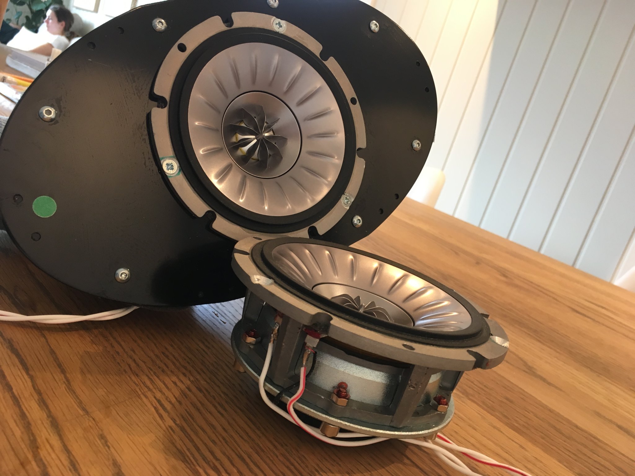

How did you get those Blade drivers? Wish such things were available to the DIY market easily!

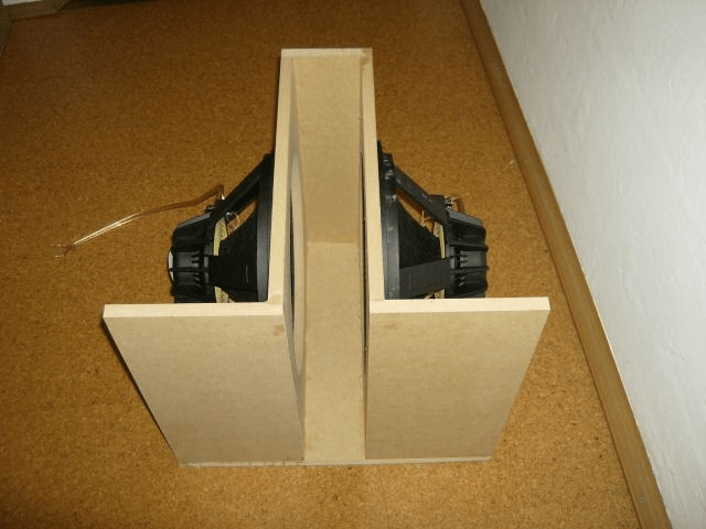

Just an idea, but could you place the RS180 in a face-to-face configuration and have then fire out a slot? This would help collapse the area of the sound source closer to the coax. Kind of like this:
(Image from google search: https://i.pinimg.com/1200x/a1/6d/ce/a16dcebf38a970fe38bfe6febc1f3253.jpg)
I'd also say with a subwoofer taking below 80Hz you just don't need 8X RS180 per channel as the coax will not keep up anyway. 3 spaced equidistant around the outside is enough to handle 80Hz - 500Hz at a level the tweeter would have thermal issues.
Spacing: as close as possible. Ideally centre-to-centre of the furthest apart driver sis less than th equarter wavelength at teh XO.
Height is usually about ear levelk for the coax.
Woofers can be placed such that (vertical i guess) modes could be minimized. having at least 4 separate woofers spaced around the room for the lowest frequencies to take mode-moinimization to the max.
The coax does not go low enuff to have at least some midBass support.

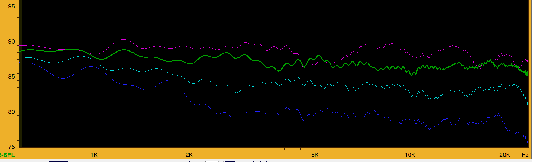

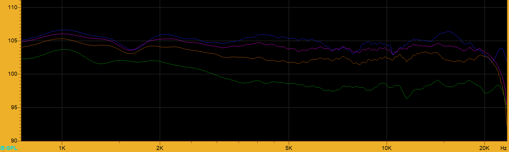

Thanks for your response. I just yesterday tried out my KEF SP1753AA in some test boxes. They definitely have better sensitivity and EQ better. The LS50 Meta seems smoother, but the dedicated midrange seems overall absolutely equally nicely playing IMO.
LS50 Meta with a bit of EQ:
And the SP1753AA with fully active filtering (DSP) LR24 at 2200:

For a woofer array you position at 1/4 room height - this helps already a lot. You can continue that scheme when you use more speakers (2 -> 1/4-1/2-1/4. 3 -> 1/6, 2/6, 2/6, 1/6. 4 -> 1/8, 2/8, 2/8, 2/8, 1/8). But with 8 speaker and from top to bottom ... I would make a 3.4 way speaker out of it! I would at least the outer 4 not let run up to 5-600Hz.
I personally like a little higher speaker so you are more flexible with different seats and also standing. But when it's for home cinema it also depends on screen height. Better a little higher as to low. You also look up to a stage.

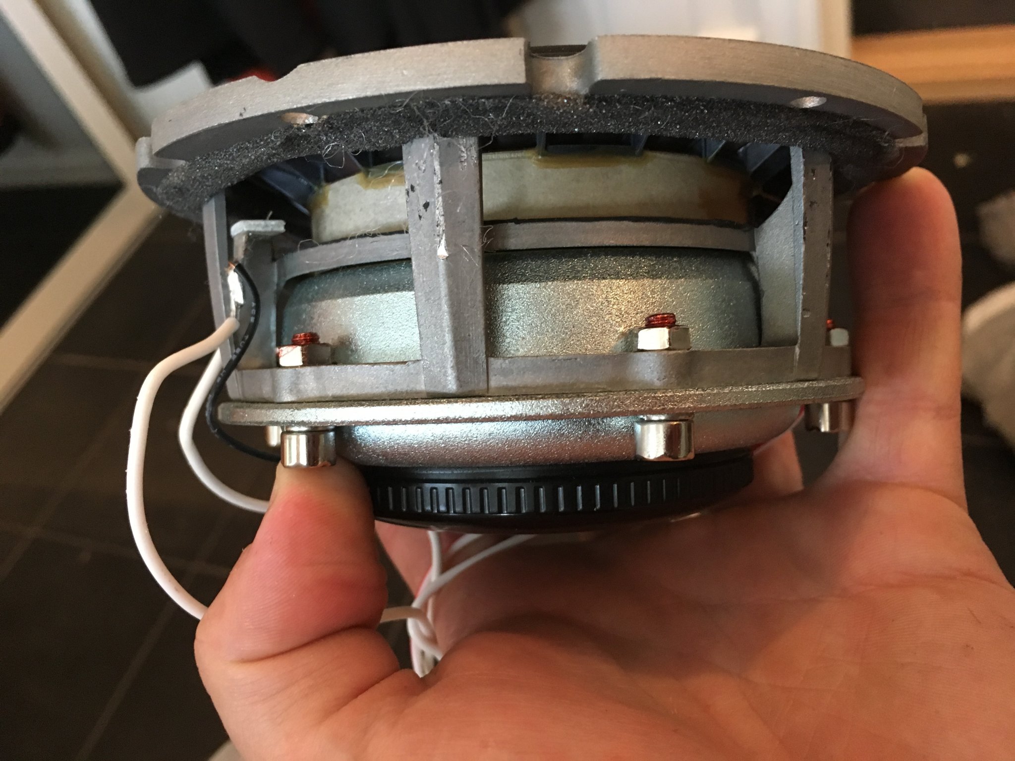

Out of interest, where did you buy the Blade drivers from?
Are they available from Kef or Kef importers, perhaps Kef dealers? Or did you happen to find some on the secondhand market ?
I have a pair of Blade cabinets .. and Kef won't sell me the drivers. I wonder if there have been upgrades and therefore some of the older drivers now available when people upgrade?
I got two of them from a french guy who got them directly from a source of him.
Since you already have cabinets, i would assume you would be "worthy" of getting these drivers, try contacting wilmslow audio in UK. Otherwise, i would think you would need to prove your ownership in some way.

Since you will be using subs, you don't need a huge number of woofers.
You might try surrounding each coax with 4 of those 5-6" woofers to create an effective point source. If the XO is 344 Hz, then spacing should be .25m which I don't think you can quite do - unless you have the woofers mounted perpendicular to the baffle and playing through slots!!!
You make a box just big enough for the coax and then surround it with a bigger box, leaving 1" gap on each side, and mount the woofers on its sides.
The reason for using multiple midwoofers in a vertical line is to get better vertical midbass / bass dispersion. IE, less room nodes.
I am not going head over heels to make the whole frequency band to be point source centered around the uni-q physically like the blade, but on a "virtual" level.
IMO after researching the subject, point source is a good idea until a certain frequency area where it starts to be impossible to localize the sound.
