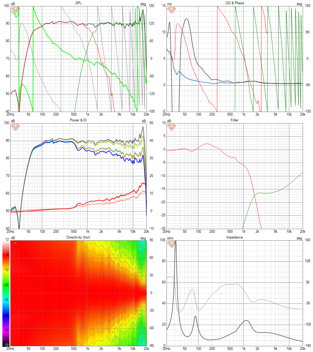

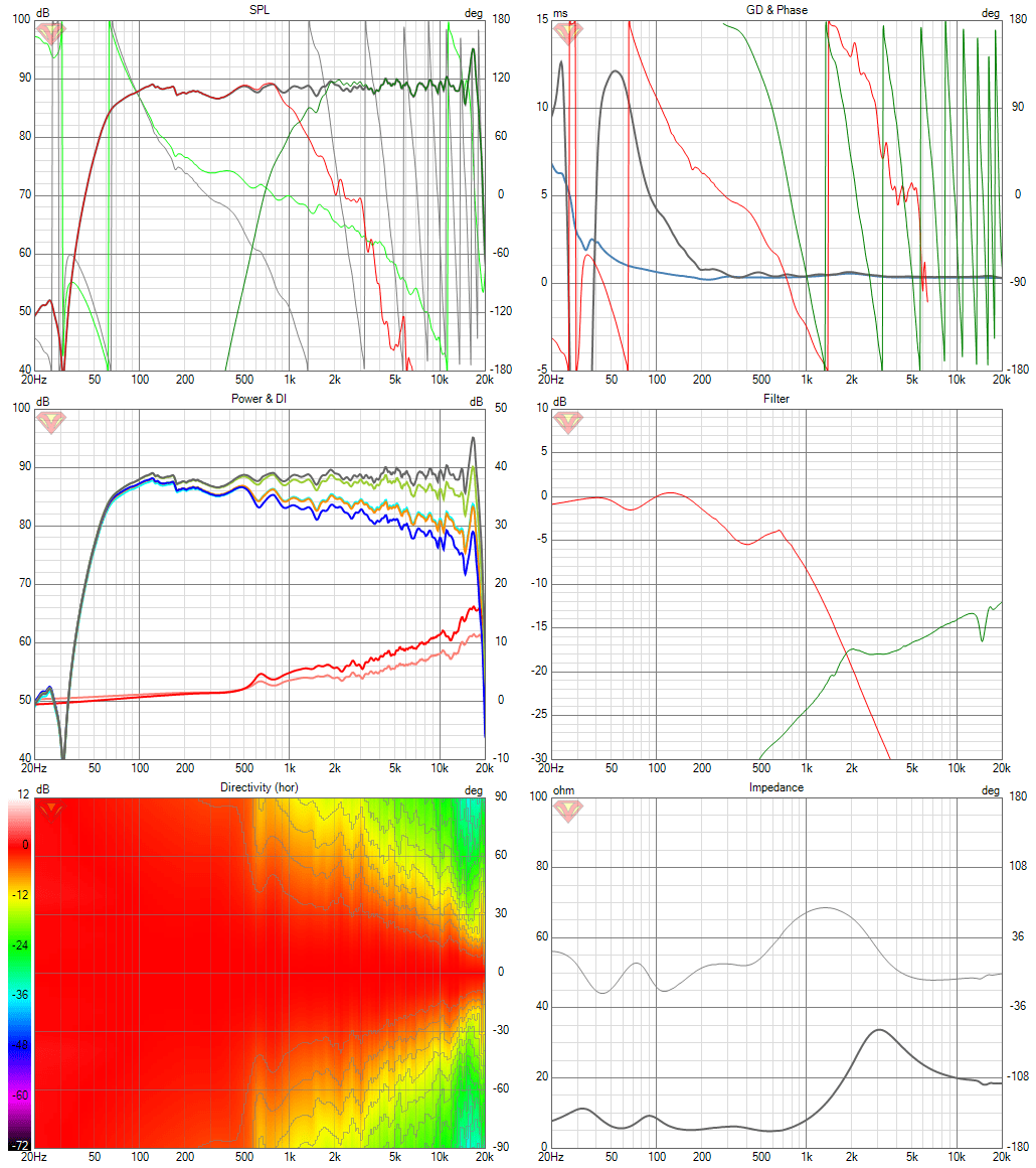

I've finished the development of a two-way speaker a few months ago. It is equipped with a Monacor SP-10A/302PA and a B&C DE250 on a P.Audio PH-230. I've made the measurements with REW, they were gated to keep out room influences, and merged with bafflestep corrected nearfield measurements of port and woofer. The measurements were made semi-two-channel.

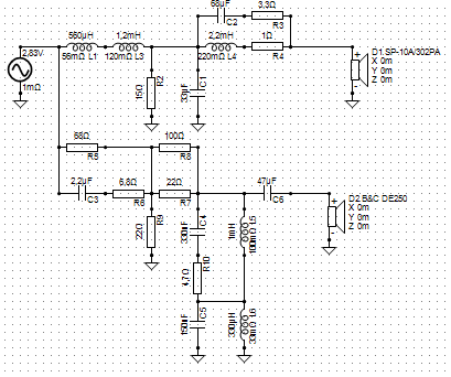

I've developed the crossover with VituixCAD. This is the result, which has already been confirmed with further measurements:
The crossover....:
....and the VituixCAD-Sixpack:

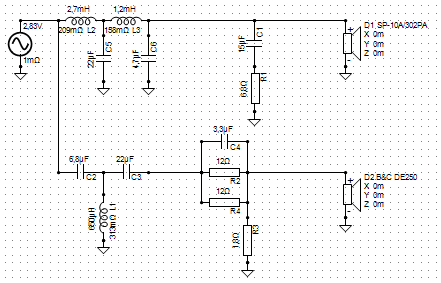

Yesterday I tried XMachina for the first time. I hardly changed anything in the options, I just limited the frequency range from 200 to 17000 Hz. I fed XMachina with the same measurements that I used for the development in VituixCAD. Here is the result:
The crossover.....:
You can see that the crossover that XMachina generated is much more complex than mine. XMachina also handled things I hadn't touched, like the peak around 18 kHz or the bass reflex bumps in the impedance response.
I think XMachina could be a useful tool if I just make more use with the various options. But I guess I can't be more precise until I've used it more.

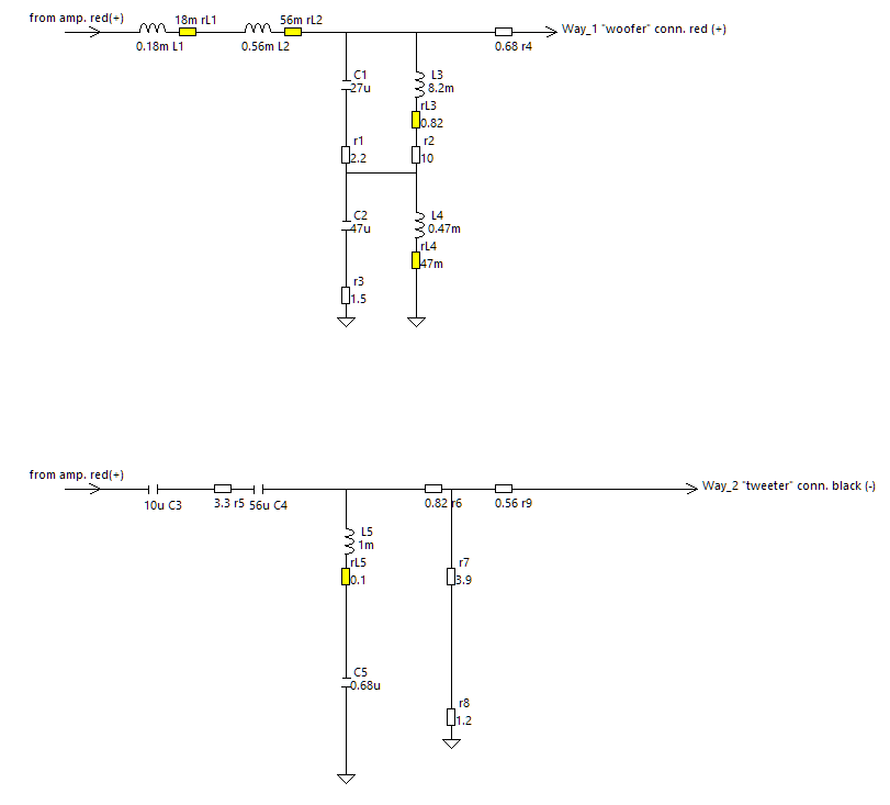

Hello, I'm a novice to be sure, but I get the feeling XMachina is quite mindblowing in its perfectionist capabilities!
My first feedback, though, is similar to earlier posts where some of the crossover schematics drawn out are extremely hard to translate to conventional software like PCD/XSim's/Vituixcad's crossover design blocks.
In particular, XMachina seems to employ a lot of paralleled capacitors that span multiple coils, as well as unusual single extra coils and resistors; even with the "circuit simplicity" slider set to 100%.
Is there a way to set it to 1000% :) ? Or rather, is there a way to change how schematics are drawn so that they are easier to translate to conventional circuit layouts?
Thanks!
This behavior usually means that some settings (targets) cannot be achieved in one circuit.
Most common cases:
-target impedance is set to 8 ohms but the drivers are 4 ohms.
-system SPL target curve is above driver SPL in its working range.
-crosspoint frequency does not correspond to value ranges of components.
There may be many more reasons for this and unfortunately they could be less obvious. And there is no tool in XMachina that can check input data consistency and display appropriate warnings before the circuits synthesis.
If such situation occurs one method is to start with the simplest and least demanding settings, then add them step by step and observe at which step the problems arise. Each step of course require another machine run to synthesize the circuits.
You can also attach your input data here* so I could take a look and try investigate what's stopping XMachina from convergence.

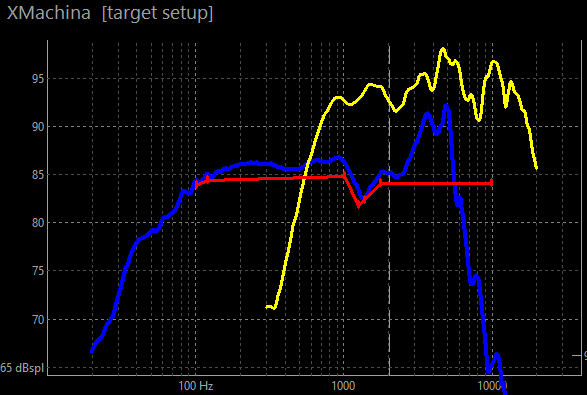

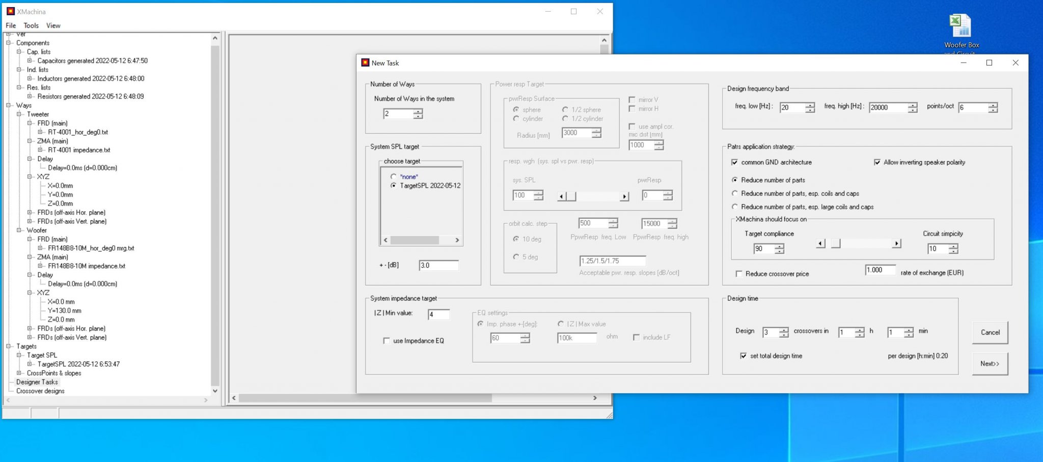

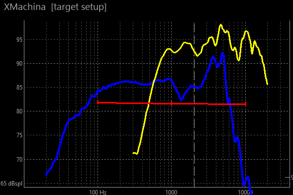

OK I created a simple project for a 2-way using 5" Dayton midwoofer and 1" Dayton dome tweeter.
  • using v1211210 of XMachina on Windows 10
  • caps, coils, and resistors auto generated using default settings
  • loaded Dayton FRD 0 degree files and ZMA files from parts express website (didn't use setup options to load)
  • target dbspl, I was not clear how to use the "follow the woofer tool" and why it is set to stop at 200hz
  • so I just clicked a manual straight line at 85db from 100hz to 10,000hz
  • crosspoints - added a 12db/oct highpass and a 12db/oct lowpass at 2,000hz
  • created a design task for a 2-way using the above spl target
  • left most options at default except "design band" set from 100hz to 10,000hz
  • "reduce number of parts" checked
  • target compliance = 90%, circuit simplicity = 10%
  • design time = 1 crossover at 1 minute
  • way1 = woofer, highpass = none, way node = woofer (not sure what this does), low pass = 2,000hz 12db/oct
  • way2 = tweeter, lowpass = none, way node = tweeter, high pass = 2,000hz 12db/oct
  • using generated components list
  • files attached below including the XMachina project file "dayton_test" (renamed as a text file)
This is the circuit it designed - it's a bit strange to my eyes. Am I doing something wrong in setup? Thanks!

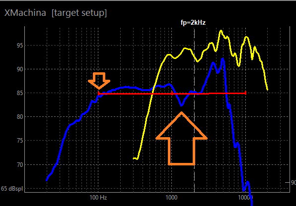

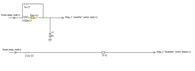

As it turns out system SPL target curve is above driver SPL in some places
It can be corrected this way:
or this way:
After the corrections XMachiana starts to respond better to the "target compliance vs simple circuit" slider setting, for example if it's set to 90% then the result can be like this:
It should be taken into account that electrical filter slope adds to driver slope, so in case of the tweeter a single cap is enough to comply with the 12dB/oct setting. To get 12dB/oct electrical, the slopes in the crosspoint setting should be increased.
I'd recommend to use longer design time than 1min even for experimenting and testing.
