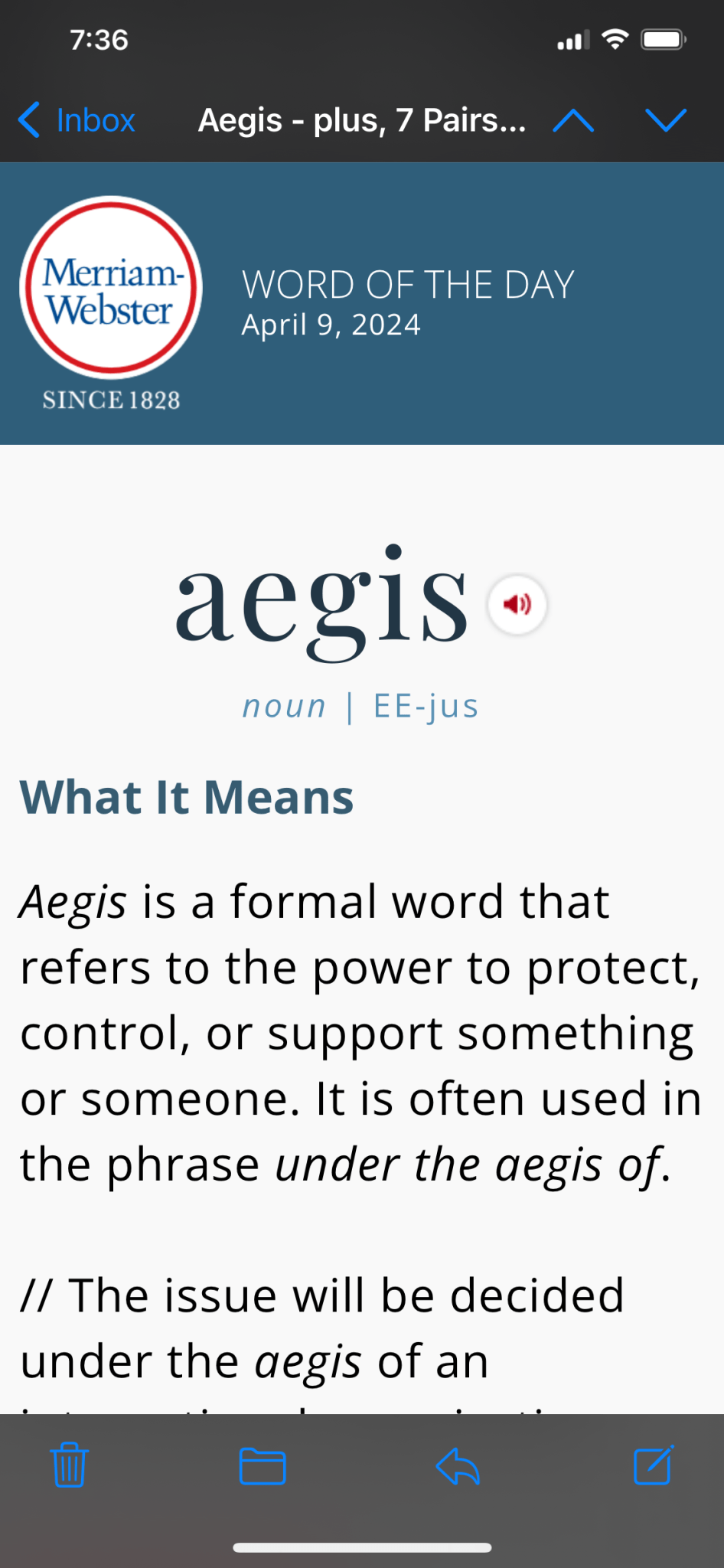

Today’s Merrill Webster’s word of the day is aegis!!!
