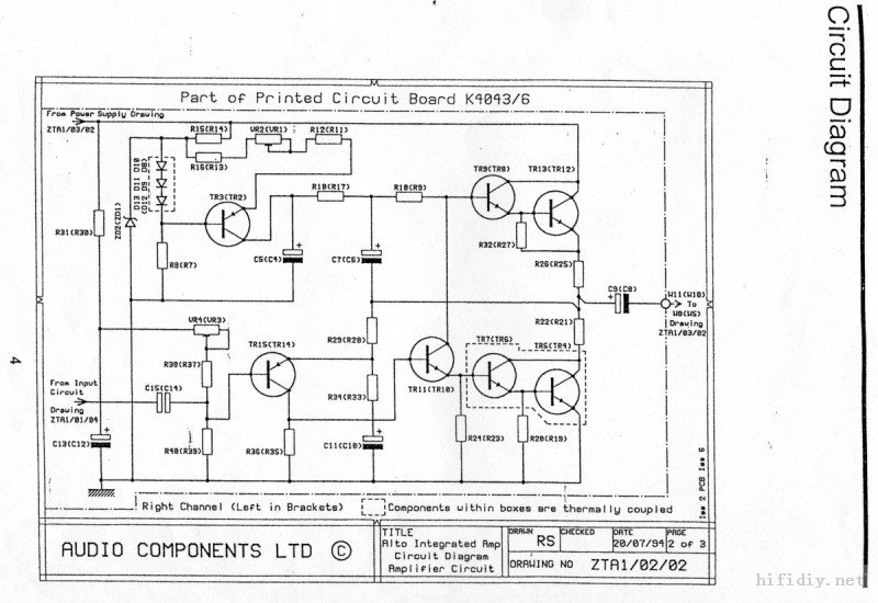

Just had a look at some web refs.
Seems the 35 is a quasi.
It is possible to reduce crossover distortion to quite low levels in a quasi, if the output is inclusive in the Miller compensation. I'm wondering if they've done something like that and operating in Class B (which would push the compensation/crossover distortion reduction a little too much) to keep the heatsink size small. Too small, perhaps, but it is also possible someone overloaded it.
https://www.diyaudio.com/community/threads/audio-innovations-alto.144893/The Audio Innovations Alto
The first models used a circuit similar to the JLH1996 with Darlington output (class AB). Perhaps someone wanted to increase the quiescent current (class A)))
