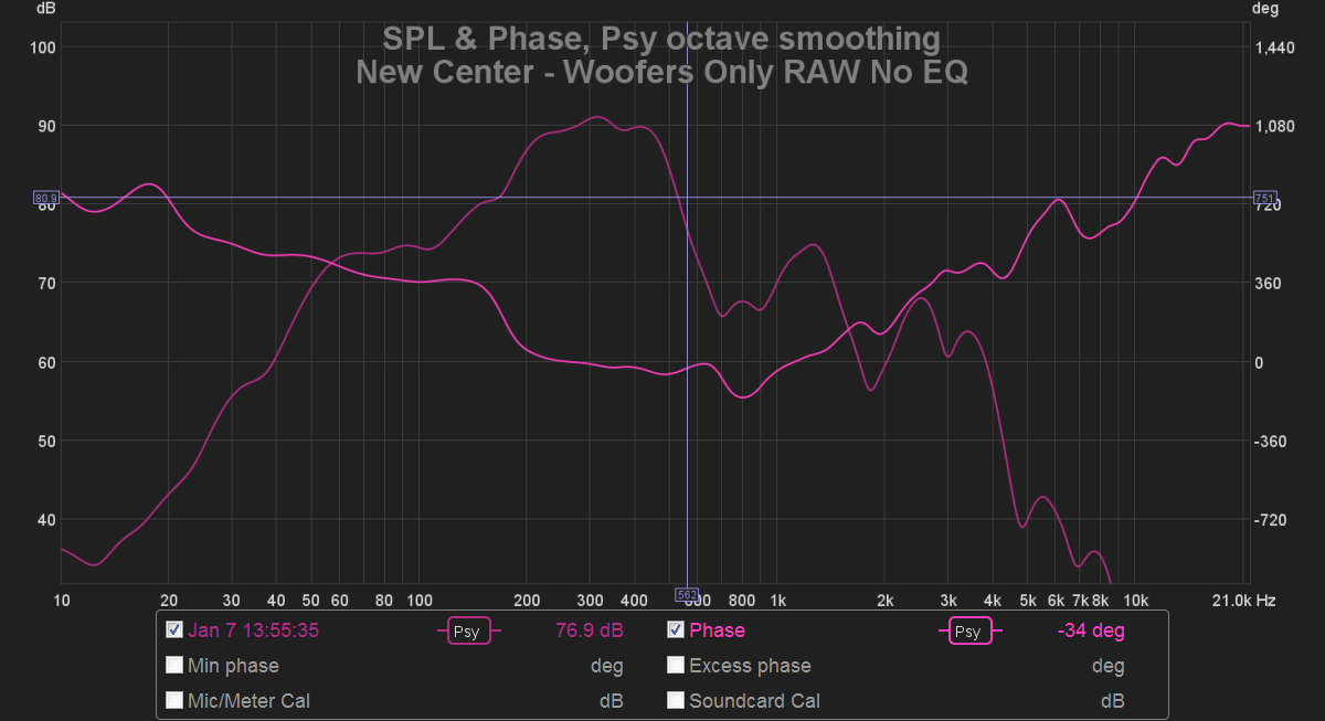

My room is long - I did not think the internal woofers would load the room to my satisfaction. And they do not. The REW measured distortion for the MEH vs the RYTHMIK is a no brainer. I do not know how accurate these distortion measurements are. In addition there is the suckout around 100 hz that cannot be cured with EQ in a sonically attractive way. Luckily the RYTHMIKs will go that high and with four of them the cone excursion is minute. This is the weak point of the system but one is not made aware of this shortcoming when listening. Needless to say I would have preferred a lower crossover point for the transition.

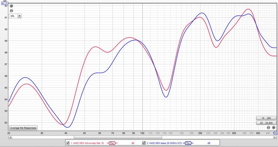

Eminence Delta 8ohm wired in Parallel (red trace) beats out the Klipsch K-33 4ohm also wired in parallel (blue trace) in the 40-80Hz range by a bit in my new K402 MEH.

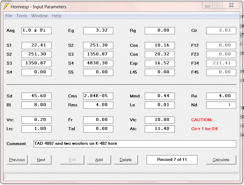

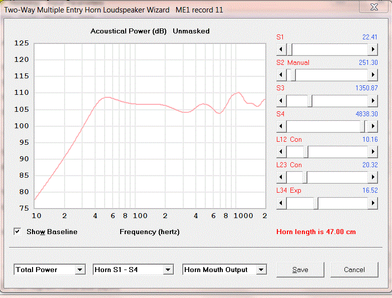

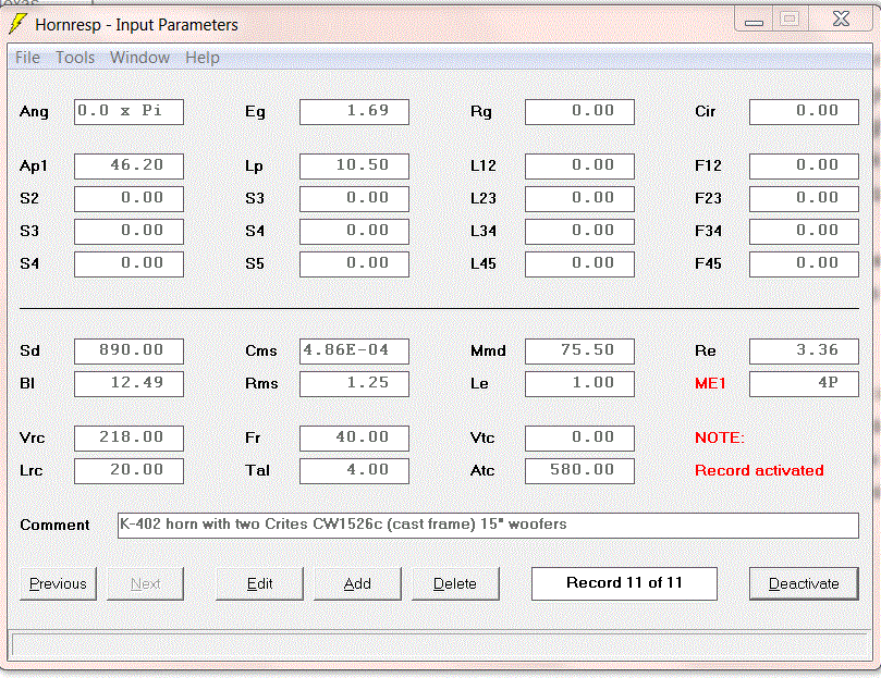

and the two woofer power output screen simulation :
